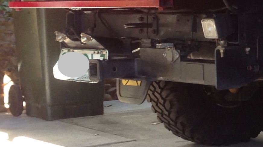

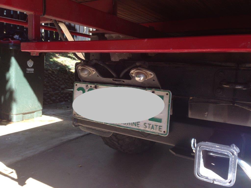

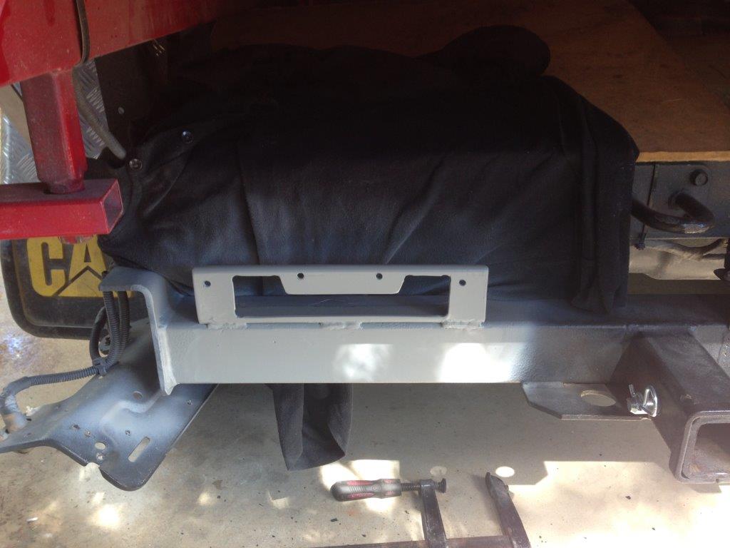

More Roofing screws. This time drilled into the tow bar to hold the number plate and its lighting system which was also too low (below the tow bar) which meant every time I touched the tow bar the Number Plate bent at right angles first.
There were 8 holes drilled into the tow bar with the roofing screws and most were not used.
I ended up making a new bracket and welded it to the tow bar and I also welded up all the holes that had be drilled into it.
Now the number plate sits above the bottom of the tow bar and so it should remain fairly straight from now on.
Number plate all bent up and hanging below the tow bar
New Bracket welded to the tow bar
After - No longer below the Tow bar
Re: Gazzas Patrol
Good stuff. A very worthwhile mod!
Re: Gazzas Patrol
Do you have a couple of screws at the bottom of the number plate? It can help when playing in water, or to be more specific, when trying to exit a creek and the number plate goes under water.
