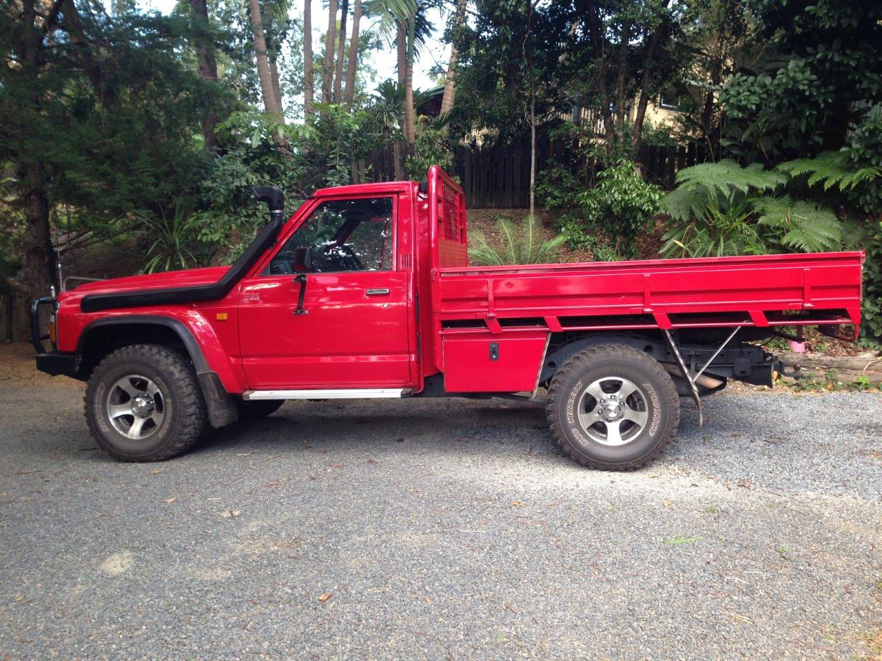

Recently bought a 1996 Nissan Patrol Coil Cab Ute.
4.2l Diesel Engine (Naturally aspirated)
32 inch Mag wheels
King Springs (Raised but not sure how much)
Extra wide and extra long Tray
Nothing too fancy hear.

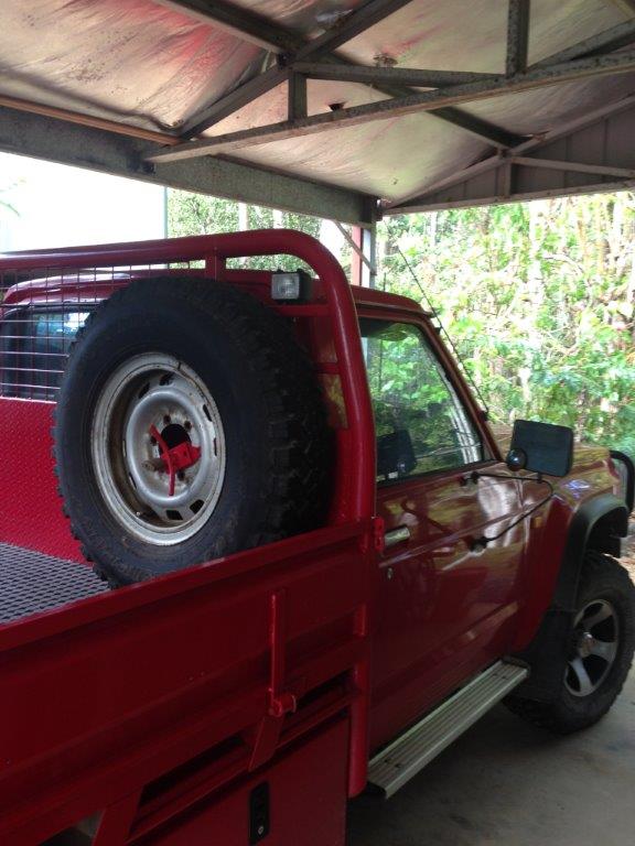

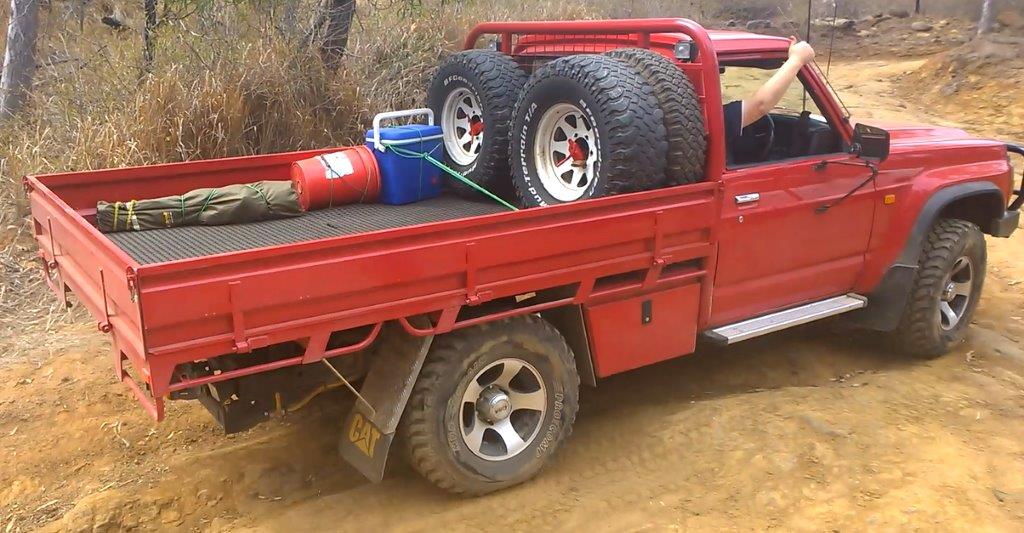

Well got the Spare wheels sorted out now. I can secure up to three spare wheels if required.
With Single spare wheel.

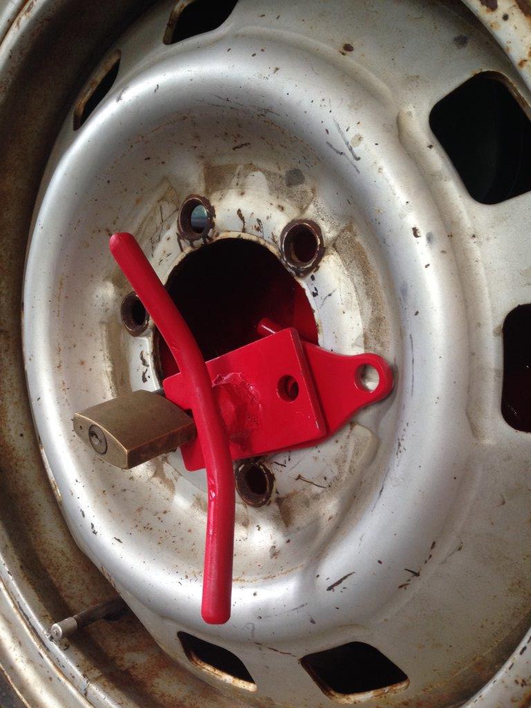

Locking the wheels - will get a Stainless Lock soon.
With All three Spares secured
